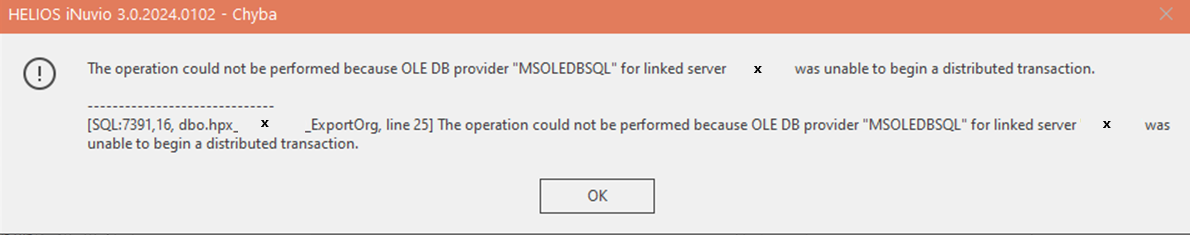

Při práci s linked serverem se může objevit tato chyba:
The operation could not be performed because ole db provider "msoledbsql" for linked server was unable to begin a distributed transaction.

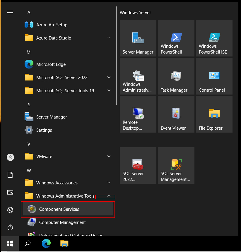

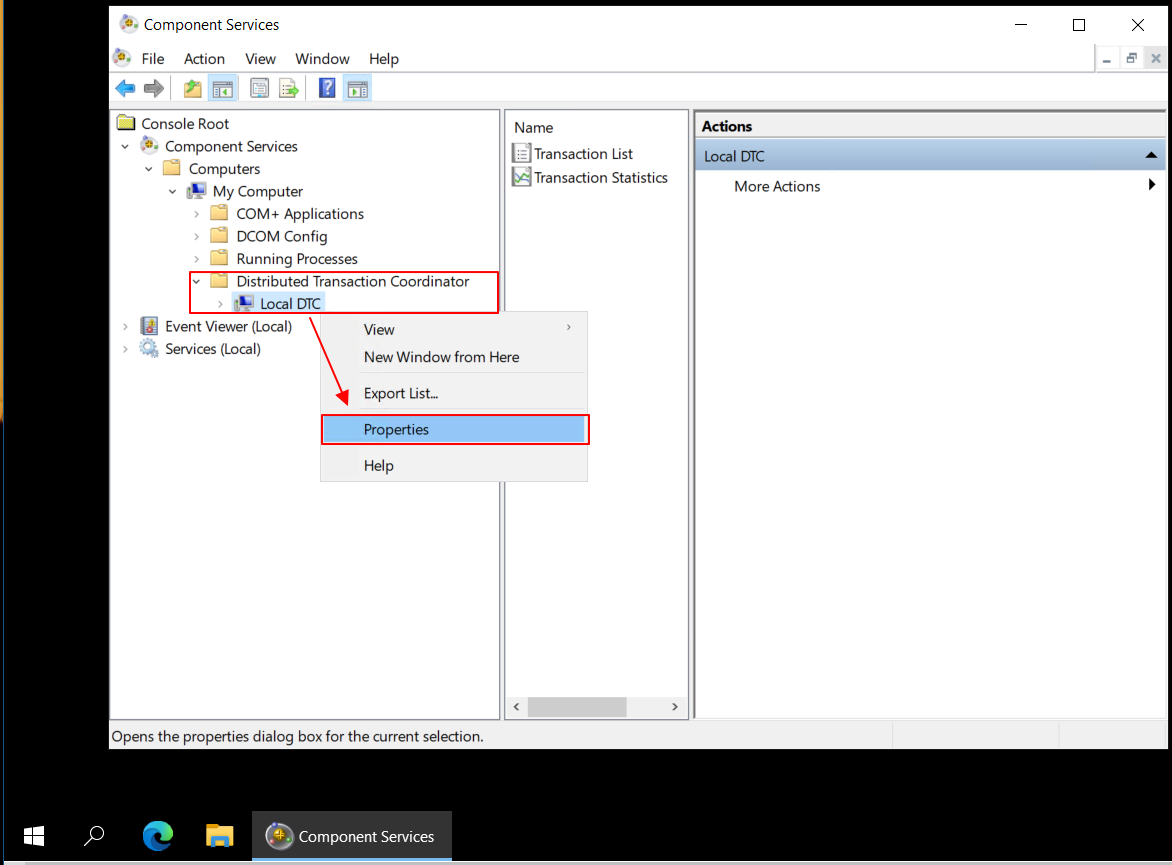

  • Windows Administrative Tools / Component Services / Computers / Distributed Transaction Coordinator / Local DTC - pravé tlačítko Properties

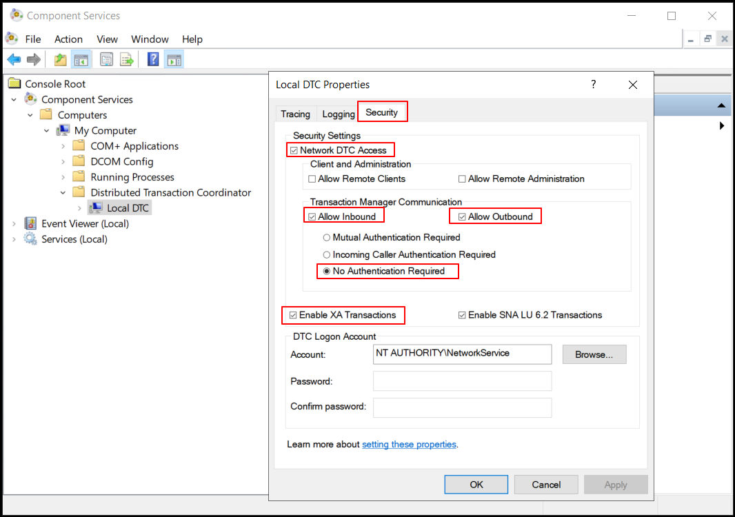

  • záložka Security - Povolit Network DTC Access, Allow Inbound, Allow Outbound, No Autetication Required, Enable XAA Transactions
